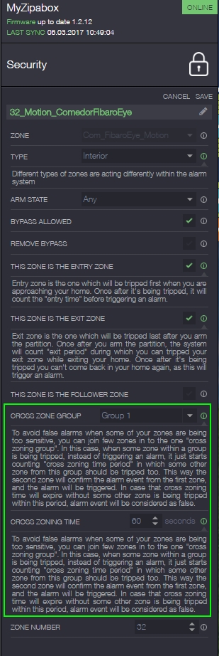

If you have aeotec sensors only sensibilty and blind time can be adjusted, if you have fibaro motion sensors you have more settings to play with. Last step but most important, is to configure your motion sensors as "Group" in your alarm zone configuration, I was having false alarms before using this setting due "masses of air moving" being detected as a person, read the description in the alarm configuration.
well said alberto. I definitely agree with the cross zoning. You can also add door and windows sensors, this way the motion sensors will only trigger alarms if the window or door is opened first. Big plus to the security function of the alarm panel in Zipato. Also you could have a separate partition for internal sensors, or rooms where your vacuum goes. And if you can set a specific time on your vacuum, you can disarm these partitions accordingly, or if the vacuum is "connected" maybe send a http request to zipato system turn on/off that partition when vacuum starts and stops.

I recommend using cross-zoning specially if you have big windows at home or somehow air currents are generated inside the house. I use mostly fibaro sensors but I have aeotec MS6 and zipato quads, I started experimenting false alarms in the biggest room of the house which also have very big windows and sliding doors, reading the manual it says that the sensor can trigger motion due masses of air moving. I noticed the configuration in the alarm, tried it and it helped a lot.
