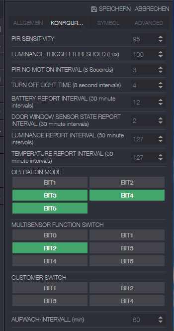

Please try this setup:
/e0e0a28c57d6ffb7fc75b1aa829e1114
