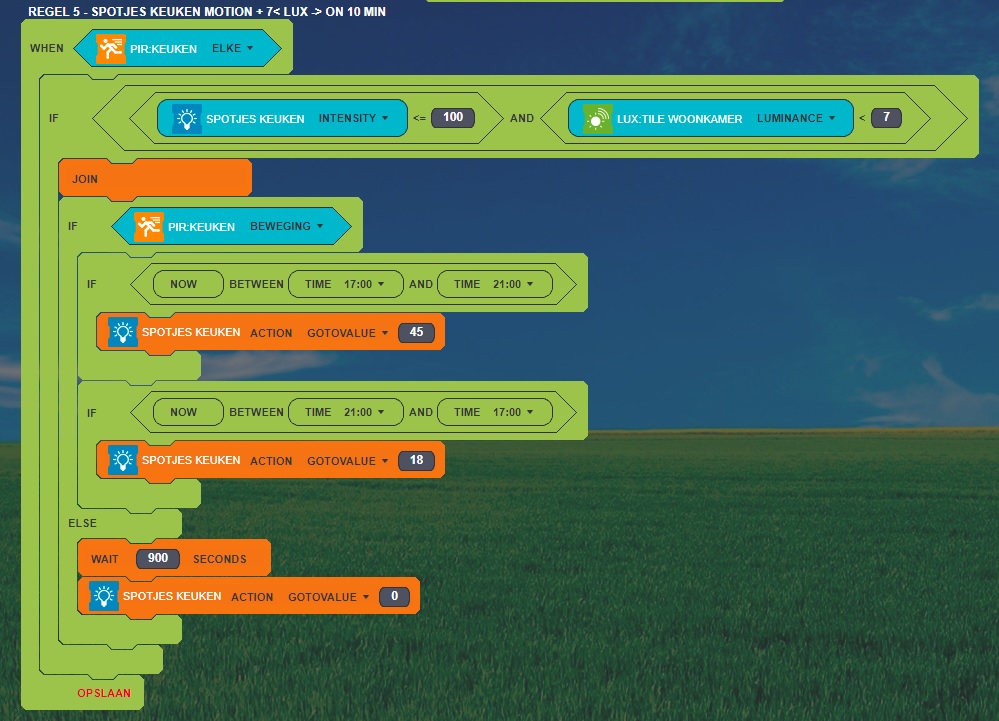

Motion rule whit time not working
I can somebody explain to me why this rule is not working?
I want to create different lighting values based on time at the day
Thanks,
Lars
Firstly you need to use the Time Between Variable block, not the Operator block.
Secondly, I dont think you can have a time between pm to am. I think time can only go in chronological order, starting at 00:00 and stopping at 23:59. Maybe support can confirm this?
Maybe create a virtual sensor instead and have this switched on/off using a scheduler at you times. I always use this method as it allows more rules to use this time stamp then, and also easier to maintain and change later if needed.

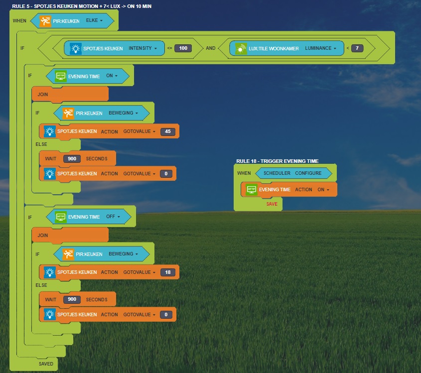

Hi Adrian,
Ok thank you for your tip, I made the following rule now
Hi Adrian,
