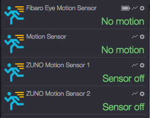

Of course this type can me changed from Device Manager, but even I'm doing it, the sensor status I can see is not "Motion" or "No Motion". Instead I can see "Sensor ON" or "Sensor OFF"
It really don't seems a big problem, but I don't know if it can affect to future rules I can create using them.
Screenshot is attached just in case my explanation is not so clear.

Zipato descriptor show state that device send to it. This is related to device and probably it cannot be changed.

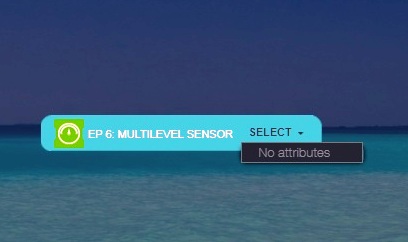

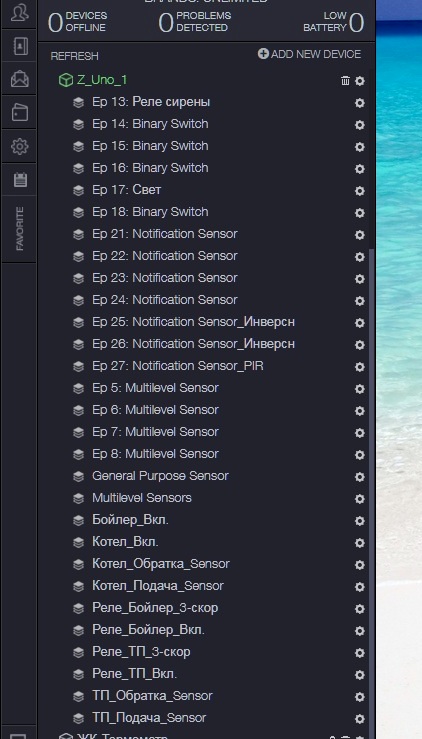

Hi, Pedro Rojas!I also use Z-Uno. Now it supports up to 30 channels! I use 8 temperature sensors, 2 motion sensors, 10 switches and 6 binary sensors on one Z-Uno and it all works well! Motion detectors are also defined as on / off, but this is not so important. Bad with temperature sensors, they can not be used in rules (no attributes). But in virtual thermostats, they can be used, strange ... I contacted the developers of Z-Uno and they are ready to cooperate with Zipato. I opened a ticket about this and they told me that Z-Uno was partially supported by Zipato. Do you get to use Z-Uno temperature sensors in the rules?
