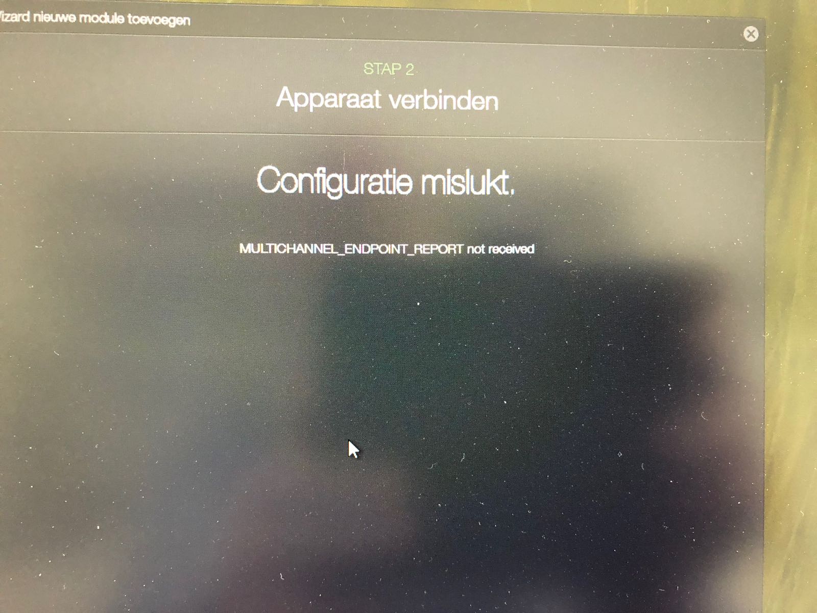

multichannel endpoint not received with cubino flush 1 relais with temp sensor
qubino PN 2MNHAD1 H 1S5P2
SN; 17205B2DA190
and temperature sensor ZMHHEA 1
controller zipato
S/N: 012E331A0E01F402 software 1.3.13
2018-05-02-PHOT...
Exclude, reset and then reinclude. Sometimes it takes a couple of tries until qubino is sucessfully included.
