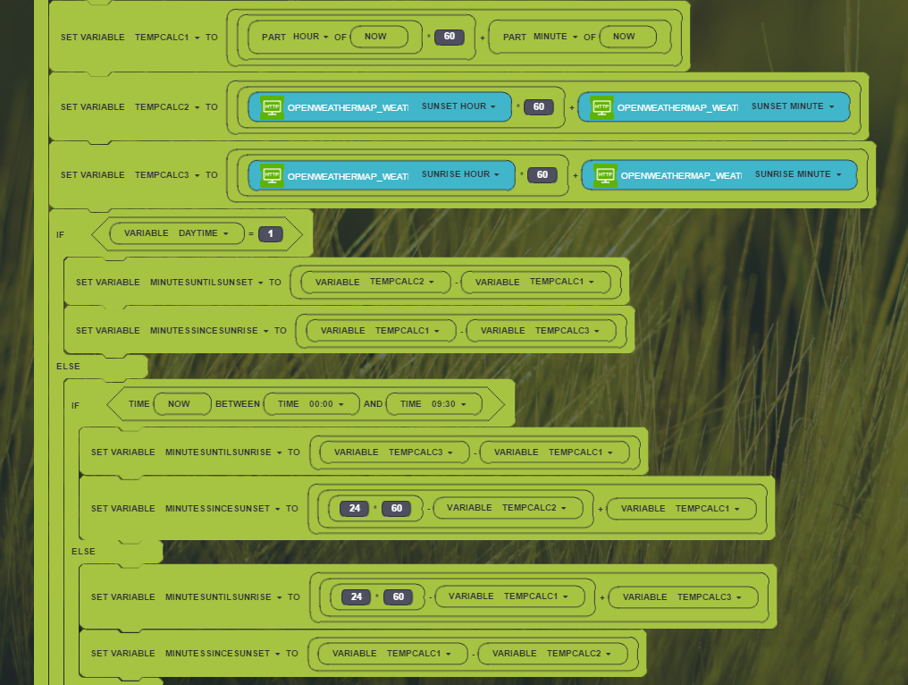

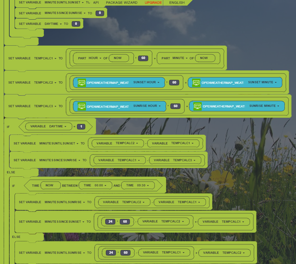

For times, it's doable if you create a subroutine to work it out and some variables dedicated to holding the values. For dates, it's nightmarishly complex. The worst thing is, it's already done - all we need is proper time variables.
A related annoyance is that you can't work with sunrise or sunset as variables. Sometimes I'd like to know how many minutes it is until sunset, or since sunrise, and then do something, or something else, according to that. That doesn't really fit into the scheduler-driven scheme that Zipabox gives us.

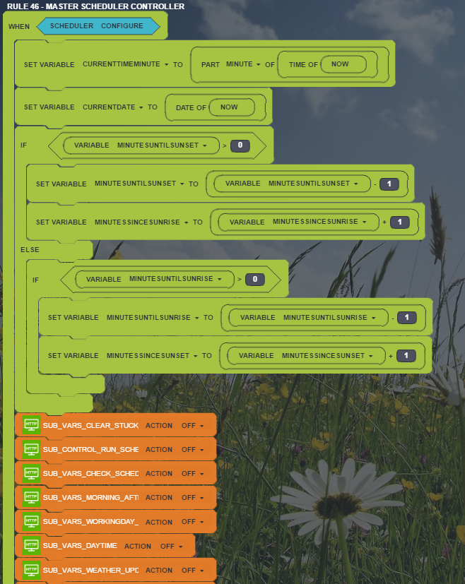

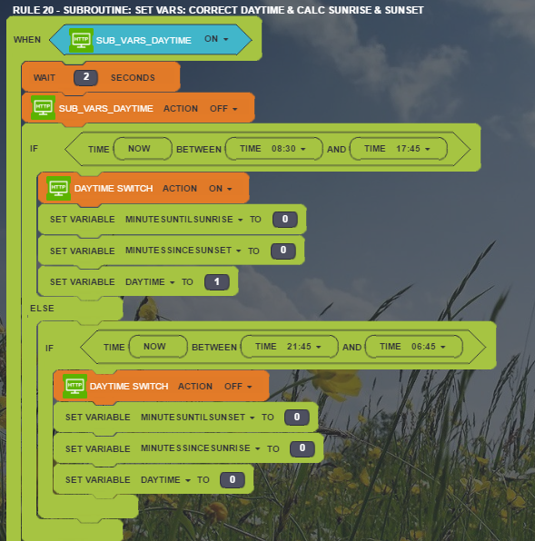

My solution is built open a few other things that I do to supplement the Zipabox's capabilities. First, I take data from external sources using a Google Apps Script, and send the data to virtual meters in the Zipabox. So, for example, I get weather data from Wunderground and OpenWeatherMap and temperature and humidity readings from my Tado thermostat. The Apps Script runs every few minutes to update these values.
I noticed that OpenWeatherMap has sunrise and sunset times for Madrid (and they're even correct - OWM is not always accurate!) and decided to try sending them to the Zipabox. Because time variables don't work, I opted to send the hour and the minute as separate numbers (the Apps Script can easily extract them). Then I have my subroutine (which also sets the "daytime" variable) work out the minutes since sunrise/sunset and until sunrise/sunset, as applicable. The subroutine runs regularly so it's regularly refreshed.
Then, to update the numbers between updates from the script, I use my "master scheduler controller" rule, which runs every minute, to add or subtract from those variables.
The master scheduler rule is what I use to run a series of subroutines that need to run every 10, 15 or 30 minutes. I find it more reliable than a whole load of rules with schedulers, which always give me trouble.

There's also a failed attempt to access the Zipato weather API there. The reason for that is that (at least in my case), much of the weather data you can see by accessing the API directly is unavailable or blank in the Zipabox itself. For example, the sunrise, sunset, temp max and temp min values are always 0 or blank.
Great work David! I will check out the script and maybe try to port it to the Norwegian open weather api at http://www.yr.no. If it's ok with you.
Marius
Sure, go ahead. If that API is good and has data for Spain, I might be interested!
Yes, I think it covers Europe, but I am not sure how accurate the forecasts are, outside of Scandinavia
David, Thanks for posting your code.
The Norwegian Meorological Service available at http://yr.no has worldwide coverage, although the granulatity is best for Norway and Northern Europe, as per their FAQ here: http://api.met.no/faq.html
They supply weather data for free, also for app developers.
Here's the weather forecast for Madrid, Spain:
https://www.yr.no/place/Spain/Madrid/Madrid/?spr=eng
Brgds Robert
Correction of my rule. There was a bug that meant MinutesUntilSunrise wasn't calculated properly.
