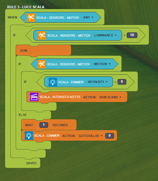

Here's the rule I'm using.
If light is off then it turn it on at a predefined level.
If light is on it keep it on at the same level until there's movement.
This is working:
This is working:
