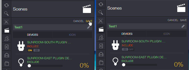

The nearly complete absence of useful documentation is driving me crazy! I'm just getting started with the system, and added about 10 z-wave devices. I can control them individually either via the web app or on Android. My next step was to try out scenes. I create a new one, select to include a particular device and select that I'd like it turned on. Then save it, and sync (as shown in the attachment on the left side). If I open it back up, it shows it device included, but the "on" changed to "off" (as shown in the right side of the attachment). I think that either scenes are broken for me, or I don't understand some fundamental aspect of their use (and couldn't find a single written word of docs/faq/etc to help.

Exclude means that the device is included I think! And you just have to chose stat of the device when you run the scene!
Not logical hope Zipato will change this!
i think they have made the text like a button. so if its red and says in include. They refer it as "push the button to include"
If you are unsure just go the the old gui EVERYTHING is more clear there. not as good looking but actually works and is better self-explaining (at least how i experience it)
Many thanks for the help. It works now! I usually feel real stupid when making a dumb error, but in what world does "exclude" mean include? Next up.... programming blocks. I do think it was clever to model the programming interface after the MIT LLK Scratch environment.
