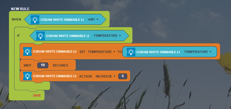

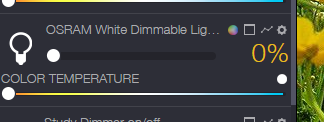

hi bill. Your osram lightify bulb should show up like this. And you can change the colour by using the slider. Something similar in the app. Via the rule/puzzle maker use the set and action puzzle to set the colour temp. You can create a variable to store colours and set the temp to this also. Aswell you can match bulbs by using the one bulb and setting the colour temp to match the meter value of another bulb.
For fade up/down, you can use the action puzzle and "startchangeup", or if you wish something slower, try a repeat block with wait puzzle and an action puzzle with a gotovalue or increase value. I have grouped the 2 exmaples in the attched pic for you

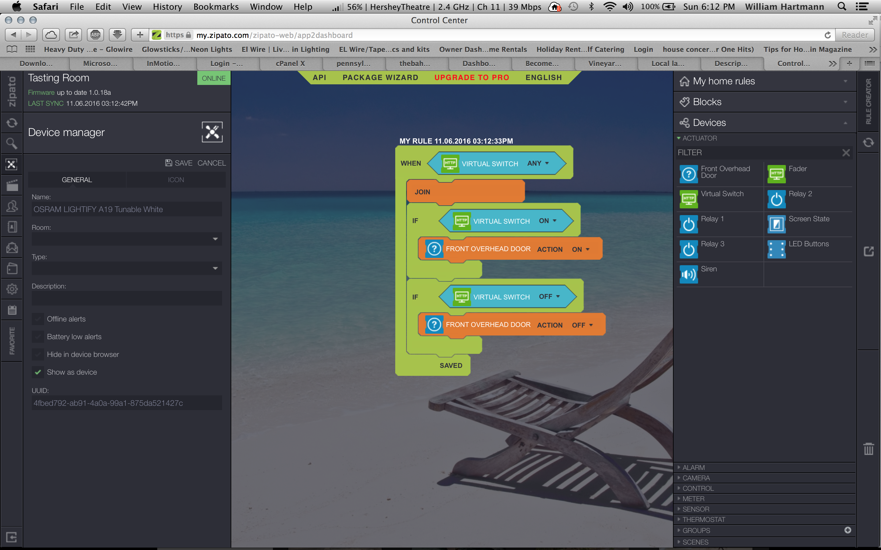

Thank you for your reply and help. The lamp did not show up as in your picture. Maybe that is my issue. Here is a screen shot showing my simple rule and how the device came up. I am not using the Osram hub since the Zipatile find the lamp on its own. I could not find any documentation to tell me if it is need or not but I do have one if that might be the issue. Any advice is greatly appreciated.
Thank you,
Bill
looks like it did not include properly. Delete the device, reset it by switching it on, wait 5 sec, off, wait 5 sec, repeat 5 times. Bulb should flash at last off. Then re include.
