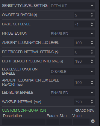

Is it possible to report/refresh the lux value of this sensor
with the zipabox.
Motion sensor works great but the lux value stays at 0,00.

I kinda have the same issue with an Aeon multisensor. Everything works except lux. This worked when first included but stopped workign a while ago.
The device stops reporting the values for some reason, please check the configuration of the sensor as it might be configured to report values only if they exceed a defined threshold which sometimes tends to be ridiculously high by default. When you wake-up the device, it should send the measurements to the controller. Keep in mind that Zipabox only displays values received from the device itself, so if the sensor never reported the value - we cannot display it.

I have same device too. I changed various properties of device but nothing changed. The manual is a bit confusing, do you have any suggestions?
I also can not use motion sensor too. A while ago everything was fine but after re inclusion, motion sensor always sends "Motion" status and never goes back to "No Motion" satus. :(
