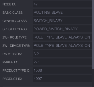

Hello. Is the new fibaro wall plug (zwave plus) not supported? I bought them yesterday and I install them today now, but it looks as if they are not supported. I install them correctly and the exclusion/inclusion was successful.
On the fibaro carton it says FGWPF-102 ZW5 v3.2 serial no. 00013378 and date 06/12/2016.
look on the picture I attach,

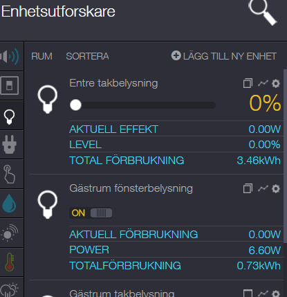

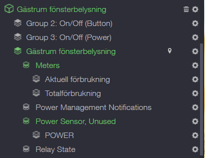

Har lyckats lägga till min och den fungerar med allt utom current consumption.

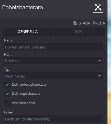

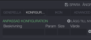

Jag har valt att lägga upp det på det här sättet, om det kan hjälpa
