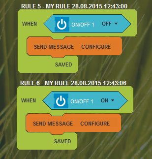

Support has verified that they have found a problem when using the WHEN puzzle in combination with "Any" on some Nexa devices (PET-910, LSWT-605, and probably others).
Use two separate WHEN-puzzles instead. See the attached picture for a workaround until they fix the bug.

This bug has been fixed by Zipato. I have verified that their fix works.
