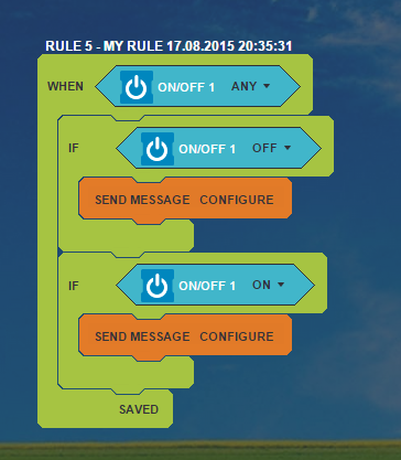

I'm having problems with the PET-910 remote aswell. At first, it was my impression that it only sends the ON command, but after reordering my rule I round out that Zipabox reports that it sends both ON _and_ OFF.
I have attached the rule I use for debugging. This rule triggers both of the IF statements when pressing ON _or_ OFF on the remote.

For now please use this device in Rules creator without the ANY condition and it will work properly.
We are resolving this issue.
