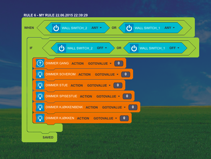

My problem/question is that is dosent matter if I press ON or OFF on the remote/switch (The rule runs anyway) and I have only selected to use the OFF command in RuleCreator.
Skjermbilde 201...
Is this normal for nexa and zipato box to behave?

Dear Stein,
For now please use device in Rules creator without the ANY condition and it will work properly.
We are resolving this issue.
