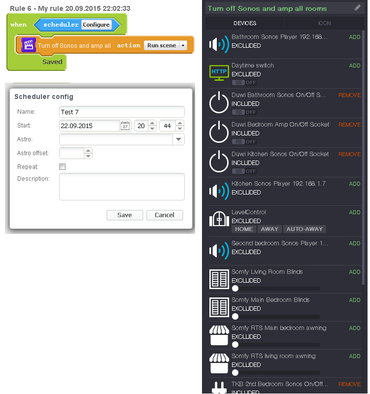

OK, here's a shot of the rule, the scheduler config and the scene. The scene just switches off a series of on/off switches (and it works when I click "Run").

I see that you are using the old UI. That's not supported, and you should use the new rule creator in the new UI.

In your scheduler you did not use "repeat" this means, the rule will work only once at given time and date and never again.

The rule is just a test, meant to run once. My proper rules are set to run every day, or every weekday. None of them work.
