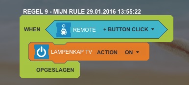

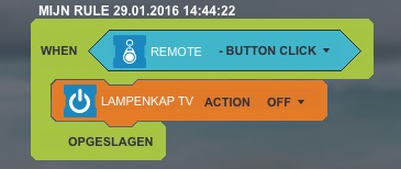

I have a new Nodon soft remote. In the rule creator I succeeded to switch on the light (see attachment), but I do not succeed to create a rule to switch off the same light (see attachment). What am I doing wrong?
i saved the rules and synchronized with the Zipabox.
I don't see anythings wrong...
No problems here. Only the round closed is not working.

I had similar problems, but after some removing and adding on the device + I upgraded the box to 0.99998m all buttons work all the time for me, also double-click.
