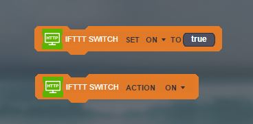

There is something fundamentally wrong in the way "SET Blocks" are displayed in the rules creator
If one wants to set a Switch to off (false) the corresponding block ends up showing:
<Switch Name> SET OFF to false
(see screenshot)
Basic coding logic would indicate that the switch is now "ON" (as OFF is FALSE). This is a bit sloppy...
Suggest to fix so either:
OFF is removed and there is a clean: <Switch Name> SET to false
Or
"to false" removed so there is a clean: <Switch Name> SET OFF

Dear Peter,
In case you have missed there is also possibility that you put your Virtual device in Action puzzle.
There is drop-down menu with options like "ON" and "OFF" as well.
Please see our attachment.
Pero Zovkic
