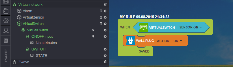

I have added a virtual switch. When I turn it on, I want it to turn on the wall plug. (as shown in the screenshot), but it just doesn't work! I have tried a gazillion of different options, devices, old and new UI to make this work, but I'm still struggling.
The event viewer doesn't show any events for the virtual switch. I have also tried to add virtual sensors and changed the state via HTTP, but not luck. It does not trigger the rule, and does not show anything in the event viewer.

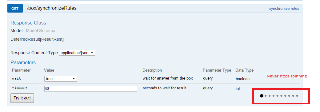

Try with the API to make sure it works:
https://my.zipato.com/zipato-web/api/#!/box/sync

I'm not able to use the API through the web interface. All operations hangs (the progress indicator never stops spinning). I have tried both the synchronize call, and tried to retrieve contacts through the API. No luck.

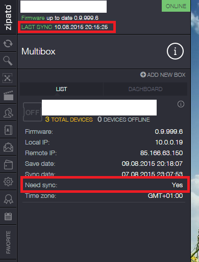

When looking at the page of the box itself, it says "Need Sync: Yes" even if the synchronize was successful, and the last sync timestamp was updated (see screenshot). Maybe you're into something - the box not synchronizing properly?
Maybe I should just create an support ticket (again).. ?

I debugged further, and found out that synchronizing rules from the API and old UI just "hanged" (no errors). Synchronizing from the new UI reported success.
I logged into the old UI, deleted all my rules and managed to sync correctly. Added new rules with the old UI and synced the rules, then my virtual switch worked with rules!
