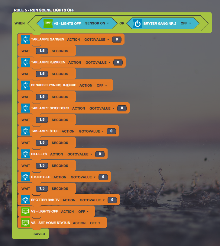

This seems to work ok. I made a virtual switch that triggers from the scene, and set up a rule as you described. Reliability is much better now. The sweet spot seems to be 1.5 seconds between each command.

This is a common problem when having too many devices in the scene. I also experienced this behaviour with qubino shutters ( I had about 13pc). I ended up using a virtual switch and added this switch into the rule with 1 second wait between shutters. Sometimes even this is not 100% working but reliable.

Another option I do, I create a virtual switch, include this into the scene, and program it so when it is switched on/off it has a 2 second delay then runs the scene again, or a select number of devices.
