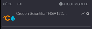

I changed the battery then deleted my device and next add it again. Now I have a device "Oregon Scientific THGR122NX multi sensor" but no datas.
Any solution ? Someone with the same problem ?

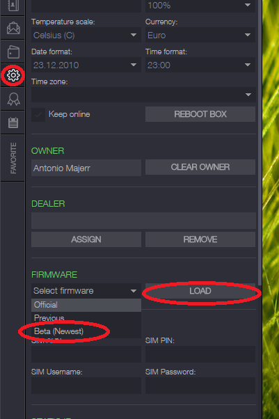

On the left side of your web browser there is a device manager. Under it you search for controller icon. Select it and search for firmware -> upgrade to the latest beta
Hello Benoit,
please see the pic in attachment, to upgrade to beta firmware go to Controller settings -> Firmware click on the drop down menu, select Beta firmware -> click LOAD and type YES.
After the firmware upgrade rejoin the problematic device and it should work correctly.
Files: Beta.png
