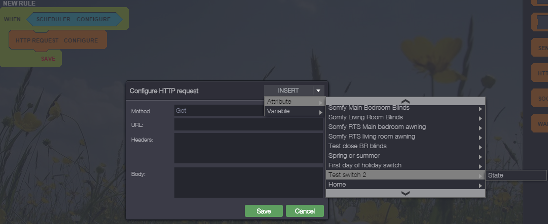

1) Reading around on this forum, some have suggested that HTTP GET currently does nothing on the Zipabox. Is this still true? Is there no way to obtain data from an external device using HTTP?

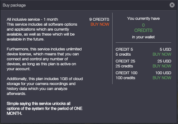

2) If I try to configure a HTTP GET request and insert attribute values from the drop-down list. I get a message about paid services. As I understood it, all services are free before firmware 1.0. (Taking into account that we're debugging it for you). What gives?

2. Zipato CEO posted an response in this community some weeks ago, implying that sending device parameters be free/available for users prior to the FW 1.0 release.

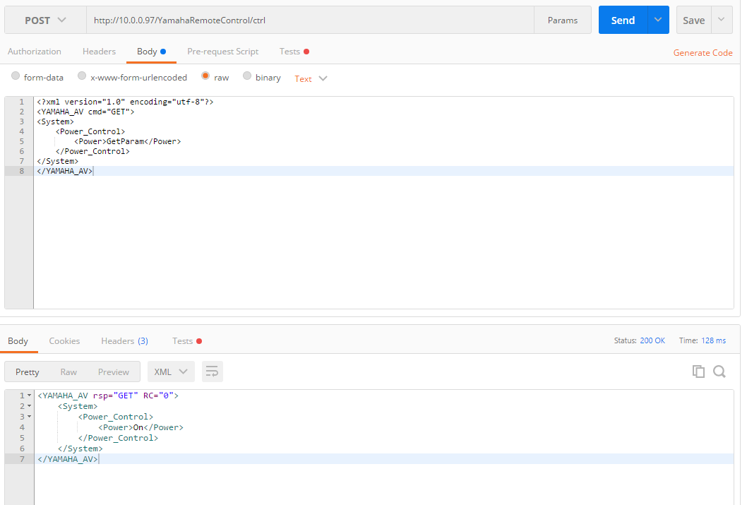

I have quite a bit of success using Post commands to control a Yamaha Receiver and LG TV via RS232 and a Raspberry Pi. I would like to start getting status back from the TV/Amp using a Post command that returns a Get responds. As per the attached file, I would like to capture the response and filter out the power status, in the attached "On". Is it still the case where the Zipato unit cant process HTTP responses.
