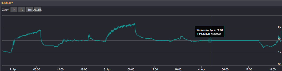

Problems that I have, is that the Zipatile goes offline almost every 2 days,
the only thing that I must do is touch the screen (it's going out off sleep mode),
then it's connect automatically back to wifi (?)
If I detect it to late, I have a gap in my trendings.......

Also today the Zipatile went offline again, from 02:08 am till 14:35 pm,
that's 12 hr loss :-(
