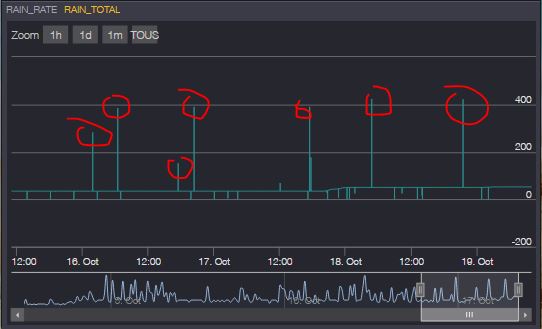

For the WGR800 et PCR800 there are some bugs, some times, some values goes to very high or very deep.
Zipato says it a problem interpreting some transmission data.....
I'have made a rule to not alarm me if wind goes over a max, and the same for the rain.

I can confirm that the WGR800 is sometime showing incohérents values. Despite the values on Oregon Dashboard are corrects....
