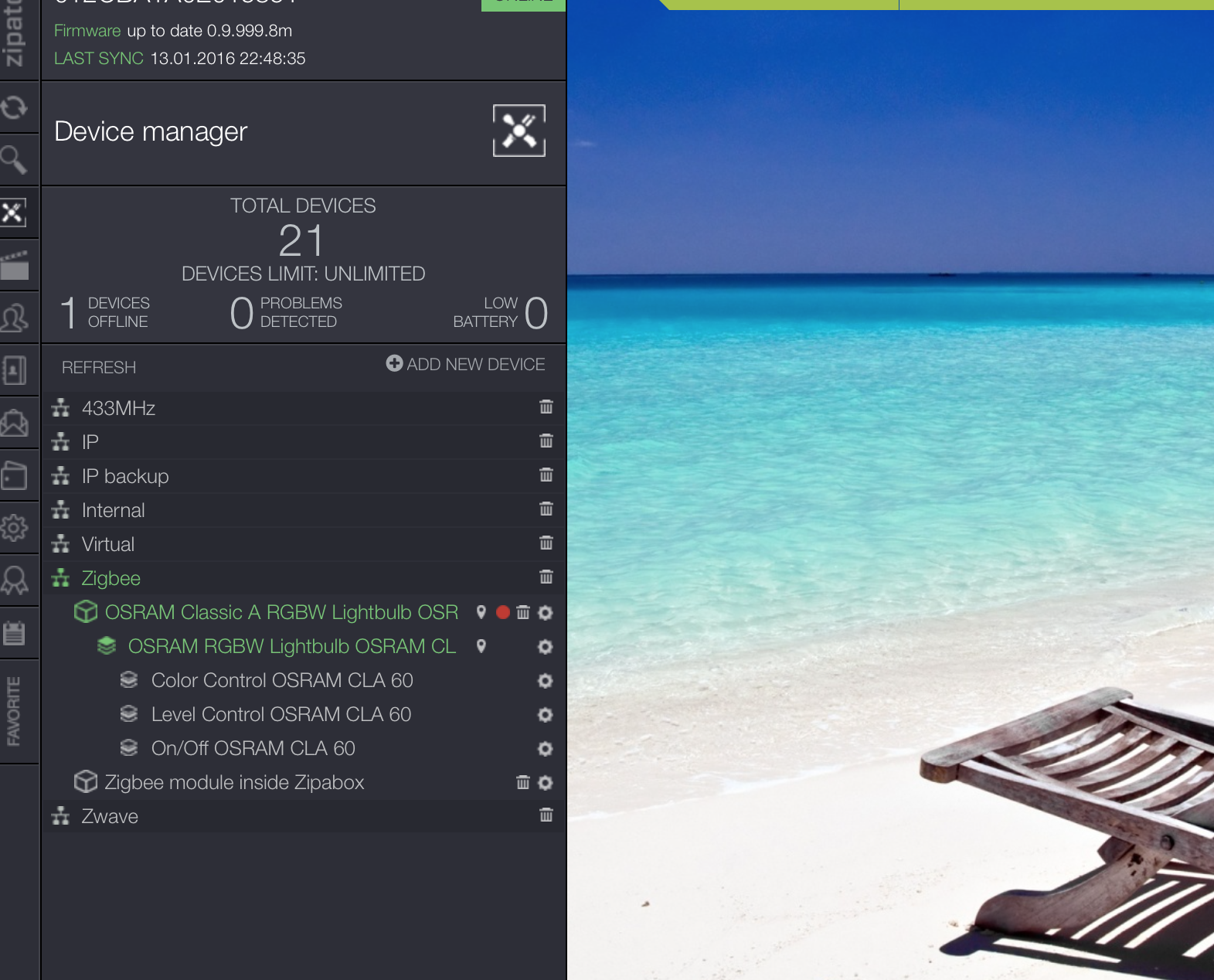

In my ZigBee Module i have include the Glow OSRAM CLA 60 RGBW. I can see it.
But in the Device Manager it is everytime "OFFLINE" with a red circle...
I can't get it ONLINE. Please help.

Do you see the following structure in the device manager:
device name -> endpoint name ->cluster names -> attribute names
Do you see the slider with the device icon?
I see only this... i don't know what i make false... is the glow out of range?

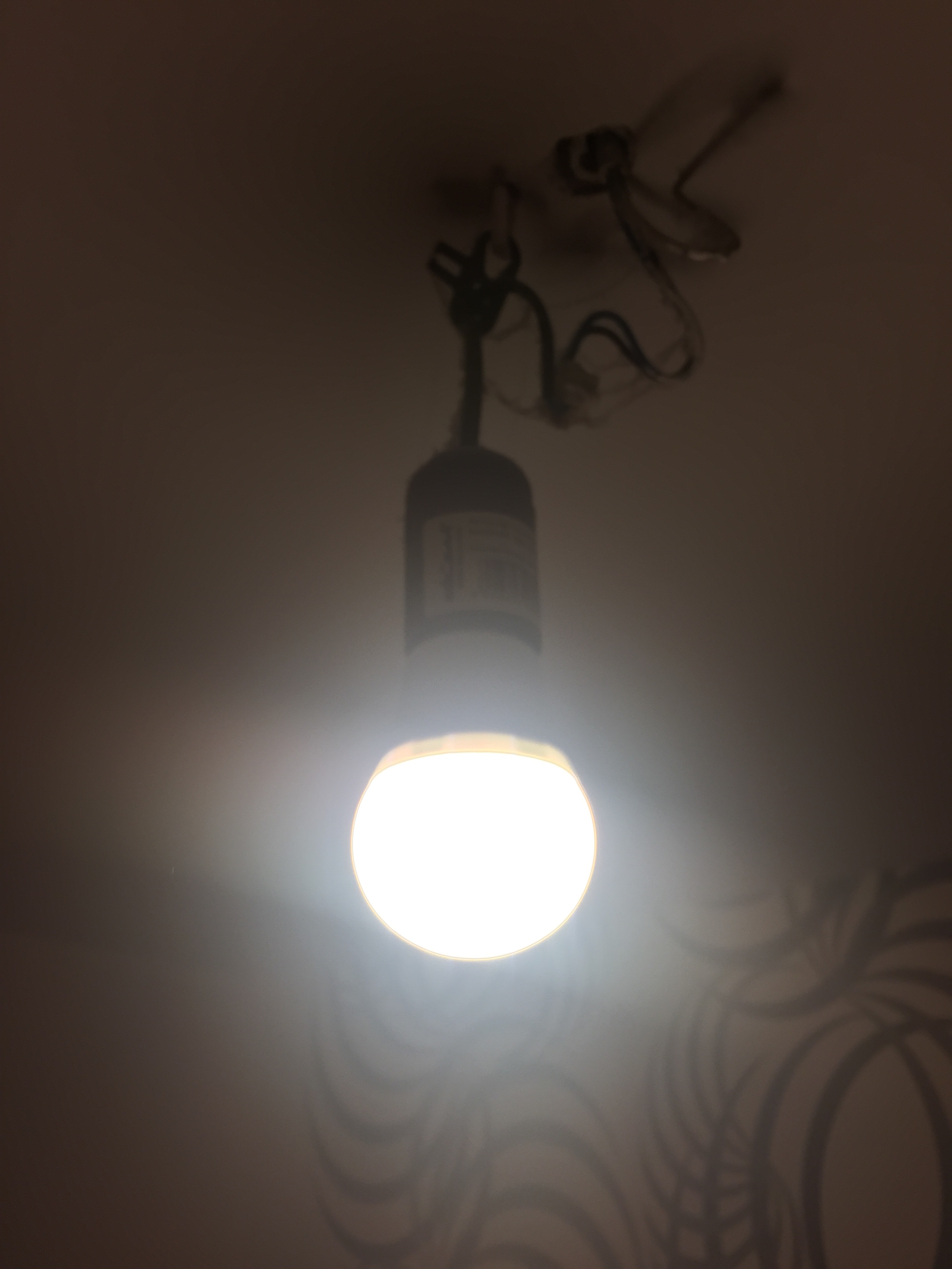

Is the bulb to far away from the box?
Is the bulb connected to the power source?
I see it is marked as OFFLINE. Does that mean you can't control it at all through web UI?
If you cut the power to the bulb and then turn it back on, is it instantly OFFLINE or after a few seconds, minutes...?

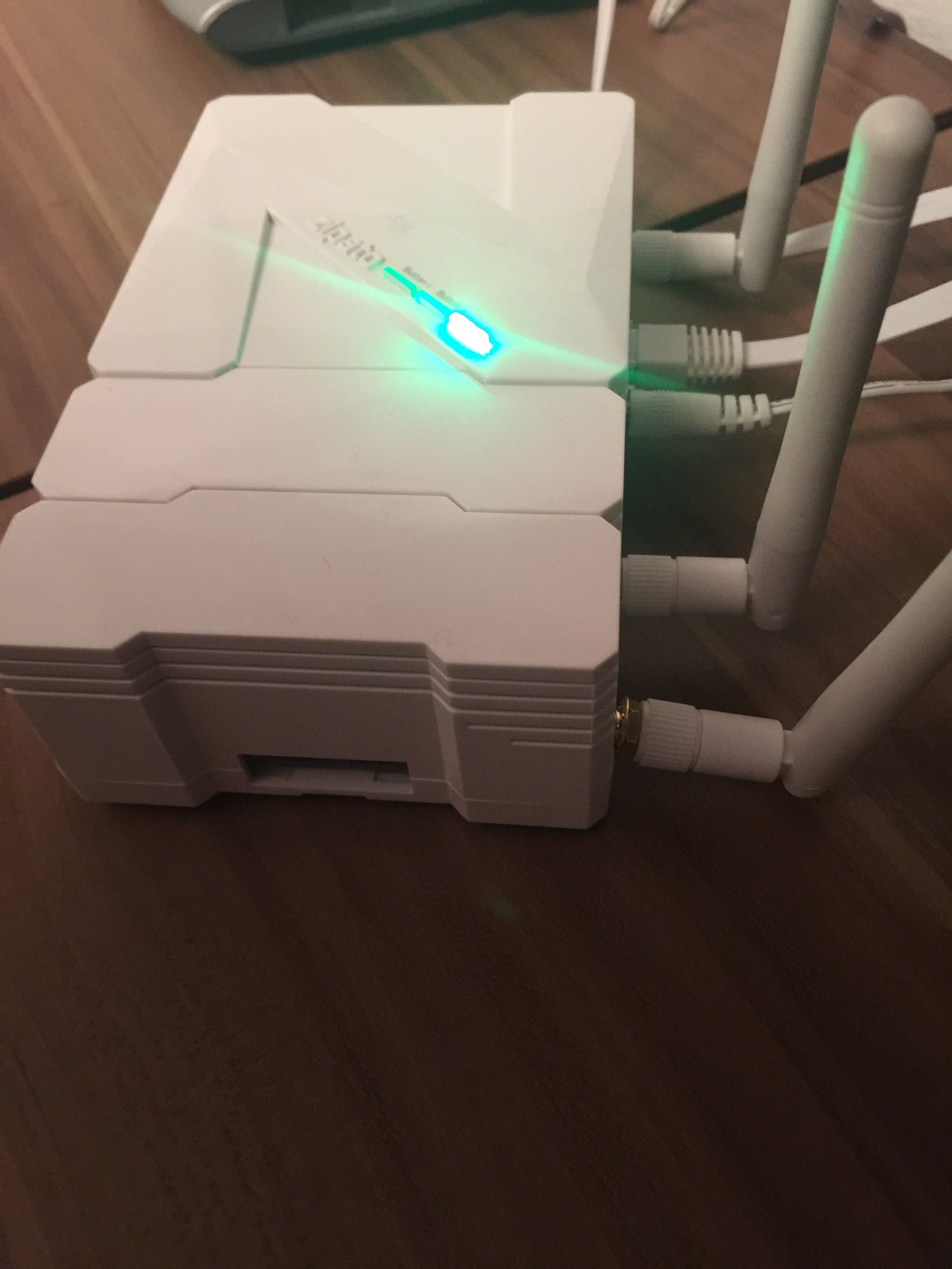

The distance is about 4 m to ZipaBox with the ZigBee Module. I realized that the antenna not exact is sitting.
I can't control the Status of Online/Offline through the web ui.
When i cut the power - nothing happens. Offline furthermore...
Can you fix the antenna? Try to screw it out and fix it back to fit better?
If you can't do that (it doesn't fit right), remove the antenna and move the box closer to the bulb, let's say 10cm, to confirm that this is the problem. On a very close distance, it should work even without antenna.
You said "I can't control the Status of Online/Offline through the web ui.". I know that, but can you change the intensity of light level moving the slider in the Web UI?

Ok i make now fix the antenna, but no changes. i don't move the box closer to the bulb because i need a extender. but i think the box recognize the bulb, its not problem of antenna...
i can change the intensity with the slider but again no change...
