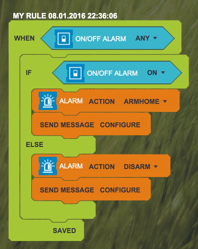

Is there a way to use the Pan06 to switch ON/OFF the Alarm (to Arm and Disarm) I can't make it work ?

If you make a rule then this is possible:
When philio = on
Alarm = armed
else
Alarm = disarmed
make sure that the quick arm option is on in the alarm panel.
Or make a virtual sensor that you use in the alarm panel.
Thanks HeroS,
I thought exactly the same but a rule like You mention isn't working :)
When philio = on
Alarm = armed
else
Alarm = disarmed
The quick arm option is on ? I am no the new beta firmware 8k
Is de philio working?
Try this:
When philio= any
If philio = on
Alarm = arm
else
Alarm = disarm
And to test put a email message in the rule and make sure that the sync is working.

Unfortunatly NOT :(
take please a look below am I doing something wrong here ? Quickarm is ON syncing is working.

Files: rule.jpg
Armhome is not working...don't ask why.
i know this sounds obvious, but you are syncing on the right side sync button for the rules.
are you getting a message sent?
