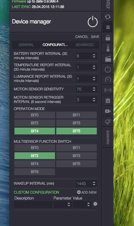

  • just noticed Z-Wave TSM02 seems to be identical with
  • PST02- in the pictures so i might have been re ordering the wrong product if you have any issues anuway here is the settings , good luck
This is screen for tsm02 sensor and i know that this senso work fine with zipabox. The problem is with PST02 (new version z-wave plus of tsm02) for PST02 IS IMPOSSIBLE SET ADVANCED OPTION

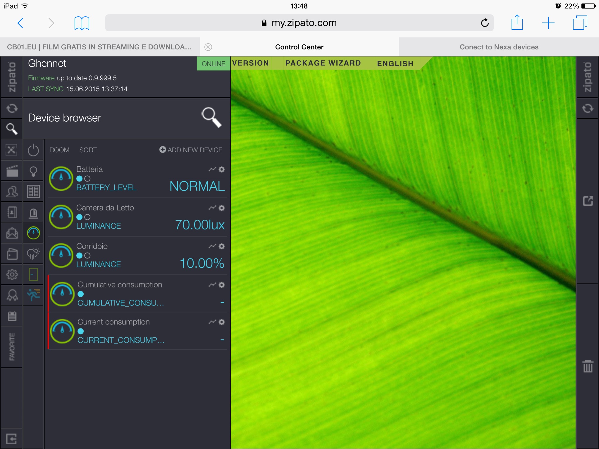

Motion detection keeps in state motion and Lume says 10% all the time. looks like temp and magnetic is working.
would have saved money if i would read before buy
Im sorry this item are not compatible. I open a lot of tikets but problems are not solvet then i buy fibaro sensor that wirk fine
I have same problem with Philio PSM02, always showing motion and 10% fixed luminosity, I hope to see this problem fixed soon

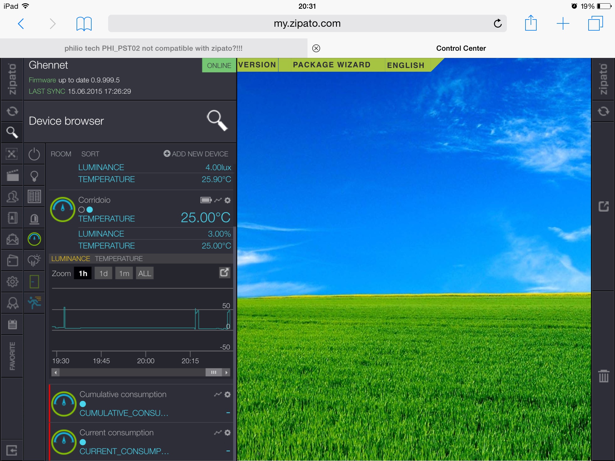

I have not changed anything, but now the sensor works perfectly
The peaks is when i turn on the light
They changed the controller and therefore the IR sensor works but I still have a problem with the luminance value which still fixed, now to 34%
