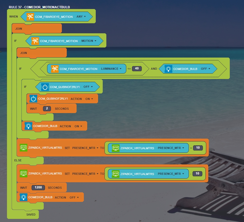

Thanks for the video, this is a good workaround to make scenes work, that way you can add both to set ON/OFF and color/brightness. I agree with you, Zipato still has some work to do regarding Hue Lights (and other devices). I haven't enabled the visibility for the ON/OFF endpoint of my lights but I noticed that on the rules you can also send ON/OFF commands using ACTION puzzle like in my attached example, I did a few tests using only brightness and indeed the bulbs did not turned totally OFF while setting it to 0% (both physically and in the hue app) that's when I decided to give it a try with ON/OFF commands and it worked (it actually turns back ON using the previous setting, which could be nice). It is confusing though since this is not enabled by default and zwave bulbs do not work that way (unfortunately they do not provide the amount of lumens and colors.
