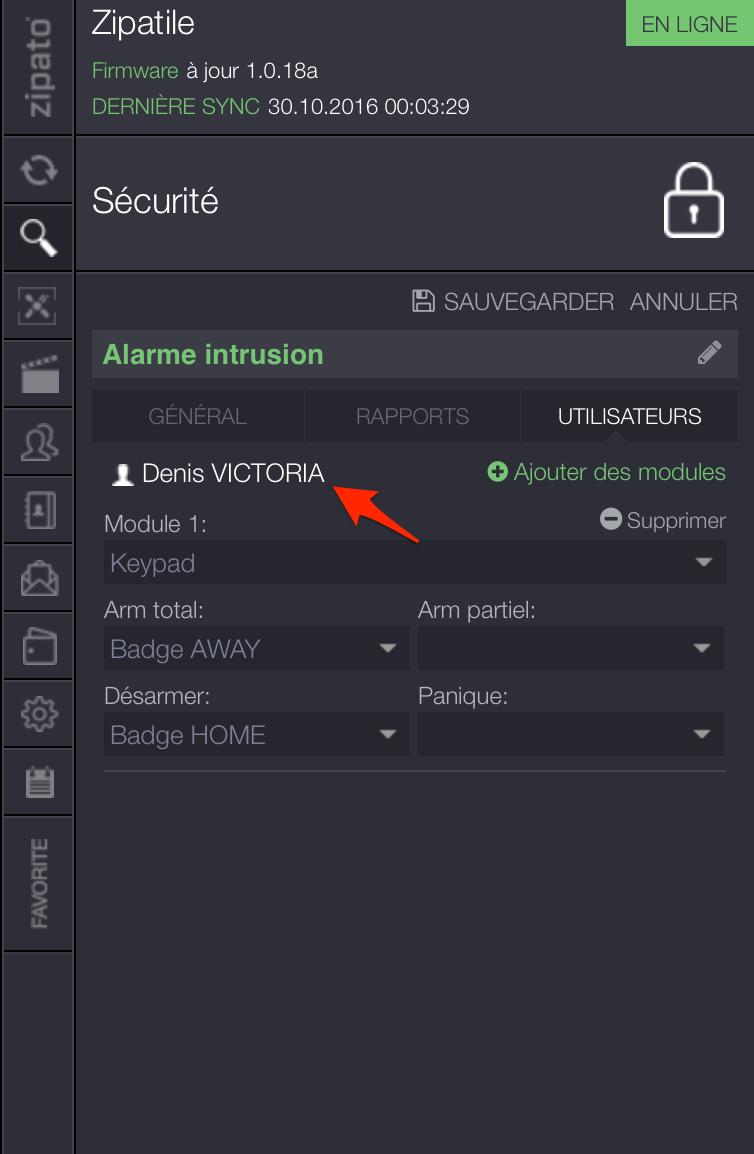

It's not obvious, but new users have to be given permission. You do this by clicking on their user name (should be formatted to look like a hyperlink Zipato!)
