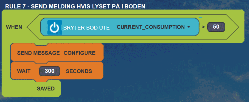

I have a very simple rule that will not run. As far as I know, it should be possible for a meter to trigger a WHEN clause?
I am using a Fibaru wall plug to sense when my light is switched on. The light reports 130-140 watts in the zipabox event viewer.
I have also tried to use the power plugs WHEN ANY with a IF current_consumption > 50 inside it. It will not work either.
I can see the events in the event viewer.
Attached is my current rule. My other rules seems to work.

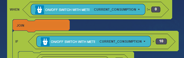

With the same device I use:
WHEN CURRENT_CONSUMPTION != 0
IF CURRENT_CONSUMPTION > 10
and it works.

Thanks Carlo, I will check if I can use the same logic.

I tried the != 0 trick, and it works., thank you Carlo :)

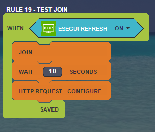

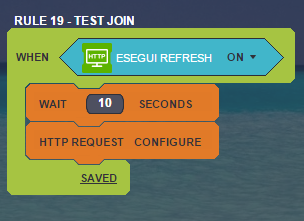

Try to use JOIN, otherwise your rule is executed continiously and takes system resources.

My sollution now is not using JOIN, but instead use WAIT 300. In this way, I get a push message every five minutes if the lamp is switched on again, or changes its consumption while on. The lamp has a built-in timer so that it switches itself off after 300s/5mins.
