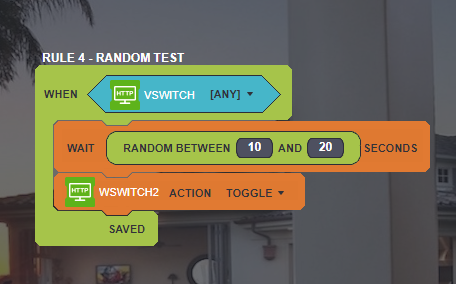

Some time ago I came up with my own way of simulating presence using my home lights, initial approach is attached. Now I'm trying to achieve the same goal but with a different, more efective and more randomized way, I'm having some troubles with below rules, does anyone know if you can use random VARIABLE on WAIT puzzle?
PresenceSimulat...
I just tested a simple rule (see fig) with Random variable under the Wait puzzle and it works.
Thanks Dino,
I think I was doing my testing while Zipato platform had some "glitches" I wasnt able to sync, I will try again and let you know.
Thanks Dino,
Looks like this works but I think I'm having sync issues again, can you confirm if there is something wrong on zipato servers?
please try again - now sync works.
I can confirm the random generator works inside a WAIT puzzle, I will post my new approach soon.
