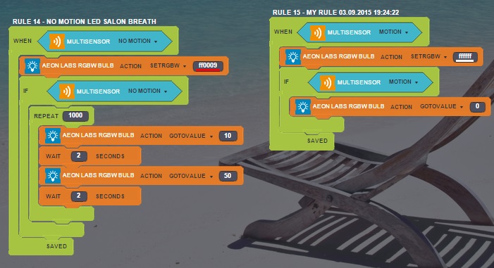

hello
Im trying to make a similar rule . but with infinite loop while motion is OFF and stop when Motion is ON
But Light Bulb goes completely crazy . The loop continue while motion is ON .
i have tried many many combination but no success (with one or 2 rules ) .
i have tried with join or stop method but seems the same problem .
any ideas ?
GiO

yes ive tried with join and stop ...

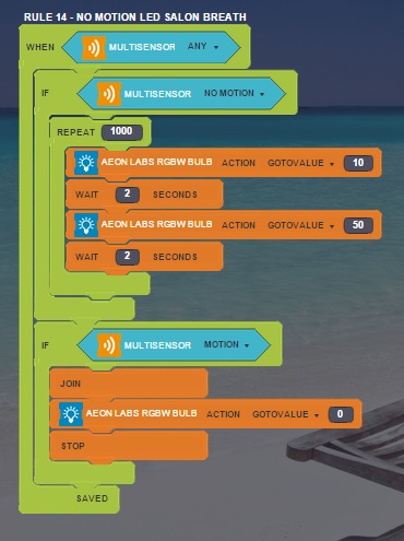

Didi you mean like this ?
but same problem .Led continue to breath but in white now
see fig
i ve tried with 4 stop on each line to the end but same problem ... i ve find this rule very complex for a simple concept
I find this case interesting . to make a simple loop who waiting a specific event to stop and launch another step.
see fig
