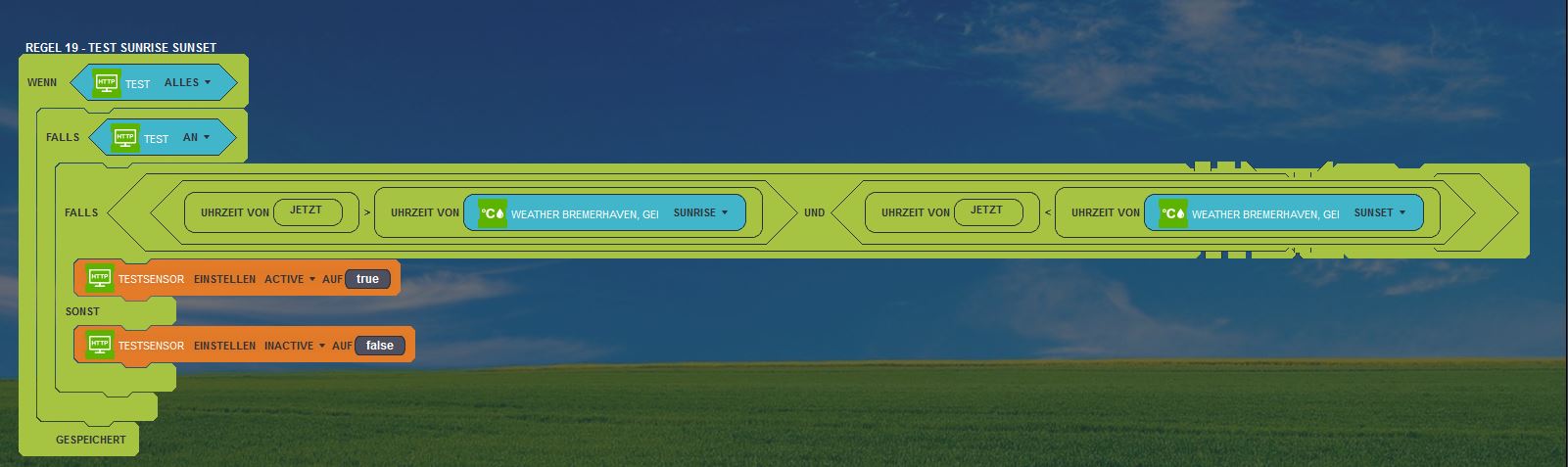

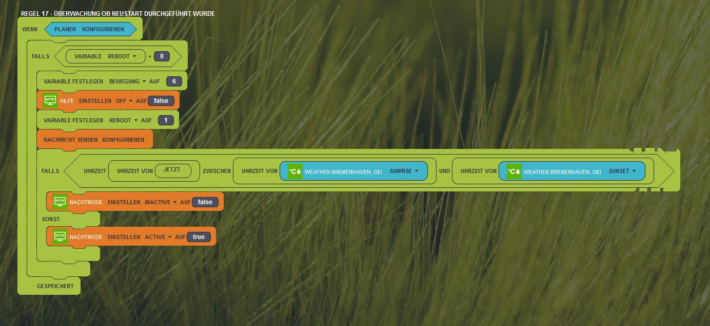

I´m not absolutly sure but I think the lower part of this rule (old rule) used to work until the last update. Its purpose is to make sure the day/night sensor is set propperly.
It was part of a routine that ran after a reboot but now it doesn´t work anymore ;-( Can anyone confirm, that those constructions used to work or should work (perhaps a fault in the new firmware)? Or do you have a better idea to set a virtual sensor according to sunrise and sunset? (it has to work whenever the box restarts so using a scheduler (which I have for normal operation, see regular setting of sensor) won´t help)

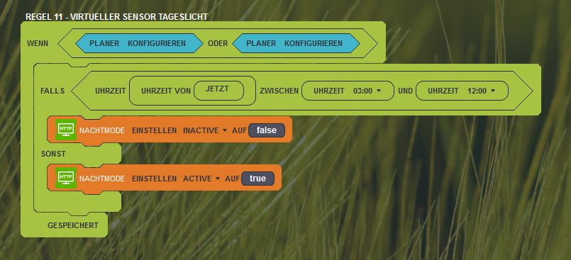

Sorry, I have forgotten this picture and can´t edit the old topic
Your rule 11 does not make sense from Zipato programming point of view. You cannot ever use anything else than one scheduler in the when block as trigger. You cannot even combine it with other states. So if you need a scheduler to start, only use one and make 2 rules if you need 2 schedulers. In your rule 17 what happens if the variable reboot is not 0. You need to remember that after restart the varialbe will have no value and not be "0"...

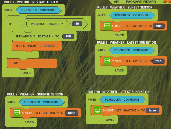

See my printscreen. The rules are named accordingly:
1. One is a simple restart tester - you cans et it to run every 5 minutes, no need to have it more frequent
2. 2 rules sets the sunrise (one virtual weather station based and another based on simple scheduler with latest possible time
3. 2 rules sets the sunset (one virtual weather station based and another based on simple scheduler with latest possible time
Hi Attila, I'm using up to four scheduler in the same rule and it works (see screenshot).
Hmmm, interesting. It was a while ago when I was told by various Power users and also by Zipato to not combine schedulers together. perhaps this was fixed or addressed with later releases.
I will give it a try as it would also help me making less rules with same effect.

believe me, the rule with two schedulers runs for quite some time and I think of it as the most reliable rule I have. I just want someting to make sure the switch is in the right state after a reboot.
And the second rule to detect a reboot is also reliable. After each reboot the variable is zero and I get an email. The only problem was, that there seems to be an issue with "Time of now is between sunrise und sunset" Als David suggested, I tried out some this part alone but to no avail. I think thats the reason, I always got the same state after a reboot, regardless of the time of day.
I then tried some old ways I experimented with in the past and this rule (of which I´m sure it didn´t work in the past) now seems to do the trick....

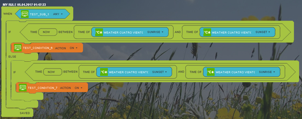

It's very strange that one works and the other doesn't (although if you go back before 1.0.17 the time of(sunrise/sunset) thing didn't work, you can see it mentioned in the firmware notes). However, I've tried it here and it's apparently still OK, and I'm now on 1.2.20.

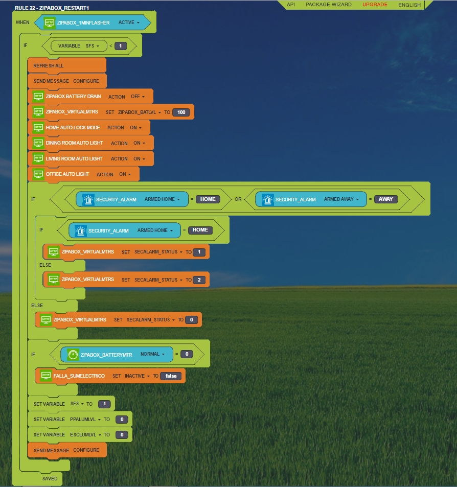

I have a 30-second delay in my reboot detector before I start setting up values. I don't know whether it's strictly necessary - I'd have to do more tests.

I'll have to check the sunrise/sunset thing. Time of (now) between time of (sunrise) etc. should work!
Thanks a lot. Then I´m going to leave the rule untouched in case it was just a problem after the update. And I forgot to say that I also had a 30 sec. delay inside my original rule. I deleted it, because I saw no effect, even though I feared that the virtual weather station meight take even longer to update the values after a reboot. And my rule to check for a reboot runs every seven minutes because I wanted to separate it from another rule which runs every five minutes ;-)
It seems to be working OK here.
Klaus, try comparing timeof(sunrise) and timeof(sunset) to 0. They're just numbers really. If they're not working, the obvious conclusion would be that the values are 0!
Alternatively, you can copy those values into variables and send them to yourself in an email. If you use the variable in a rule, it will always appear to be zero, but in the email you can see the real value - weird. As a control, include another variable containing timeof(now).

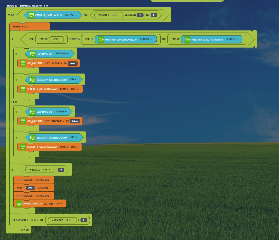

You have to use TIME OF NOW BETWEEN TIME OF as you already mentioned. I noticed sometimes this didn't update after a reboot, this sould be related to the update of the service for weather forecast that zipato uses. I went around that with two rules, one that runs immediately after a reboot and the second one runs 5 times after the first one, every minute, this way my virtual sensors are always correct.
