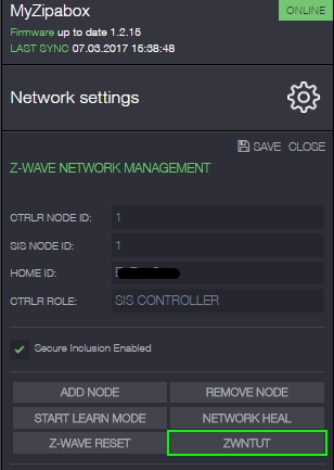

Does anyone knows what this function is for? It is under Z-wave settings...
Best Answer
Greetings,
ZWNTUT (Z-Wave Network Topology Update Tool) is a tool that can be used to recreate the routing table of an entire network, or just to update the routing table of a single device. It is basically just an improved version of the current Network Heal tool.

Your main/primary controller will also be Node and SIS ID 1, Your Home ID is the ID number that is associated with your controller. This is what a device gets when it joins your network, and helps to identify what network it is on for future commands. SIS controller is the type of controller it is. There is SUC and SIS. SIS is more common as it allows multiple controllers in a network. SIS controllers do not update other controllers with new routing tables whereas SUC do.

Well, I have used this feature and it basically recreated the actual routing of all devices.
From my perspective it is better featured tool than Network heal and you should use it at least one on all your devices (just run all devices and dont forget to wake up battery powered devices when you are prompted).
