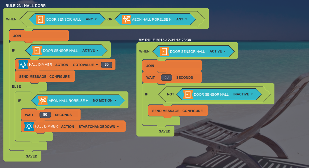

I want create rules that send push notification when I open the front door and if you don't close the door with in 30 seconds i want to get a notification that the door is not closed.
I created 2 rules but it does not work as it should.
If I open the door I get a Push.
But if I close the door before 30 seconds I get both the pushes? Bothe the door is opened and door have bin open more then 30 seconds.

You will need to set your wife up as a user as well as a contact. This will give her her own login and push messages.
As for the rules, you will find the door sensor is probably still active for a number of seconds before it returns to the inactive state if it is closed to soon. Put the send message puzzle in the first rule below the door sensor active into the second rule above the join puzzle. Also you could be getting messages from the motion side if the door is open.(unless this is what you intended) Also not sure on the type of motions sensor you are using, so any change in state, temperature, light etc could trigger a message if the door is open. May want to change this to motion state
The second rule has two negatives in it also. You could just say for the second sensor, "if" puzzle with door sensor active, instead of not door sensor inactive. Not sure why this would be sending though if the door is closed under 30 seconds.
Hope this helps, let me know how you go

I still get the 60 second Push even if I have closed the door, and there is not very good events representation and I don't see mush changes in the events.

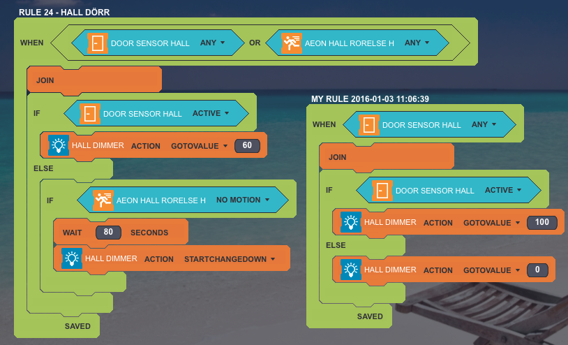

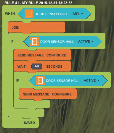

Hi Stian and all!
Support helped me with a rule that worked, forgot to say. I don't really understand why, but it does. Thank you Zipato.
Her is the rule:
Hi Stian and all!
Her is the rule:

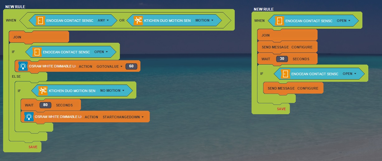

oh yeah, should have had the "any" state first, sorry. You need this to trigger the event properly. Otherwise it could trigger any time, or sometimes not at all. My bad.
