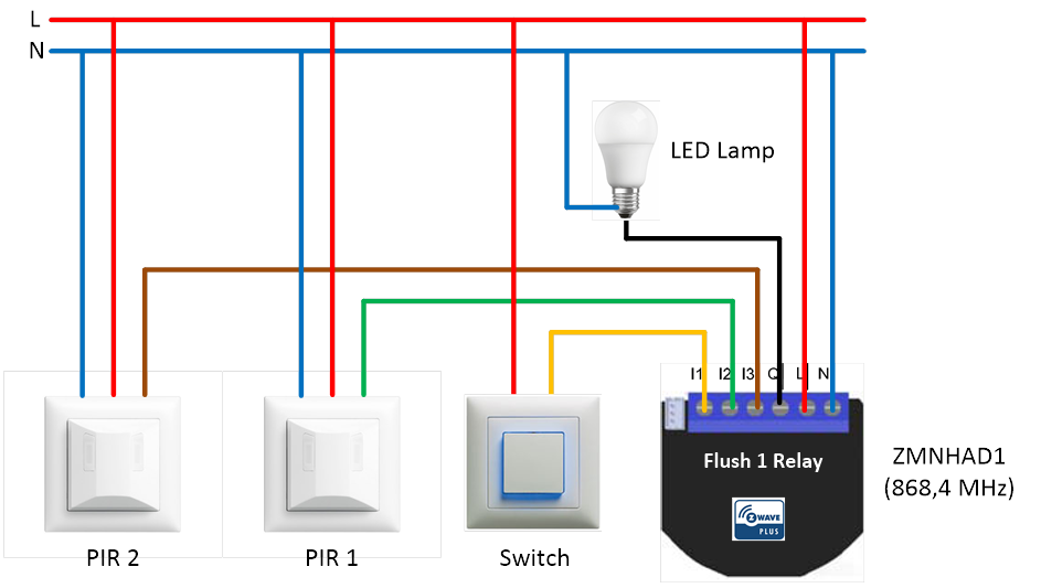

I have similar problems with my qubino flush 1 relay (ZMNHAD1). I need I2 and I3 as inputs from two PIRs (see picture). I changed the parameters 100 & 101 from 1 to 9 and back. Without any success....
I think ThinkPad is right, the problem is the zipabox.

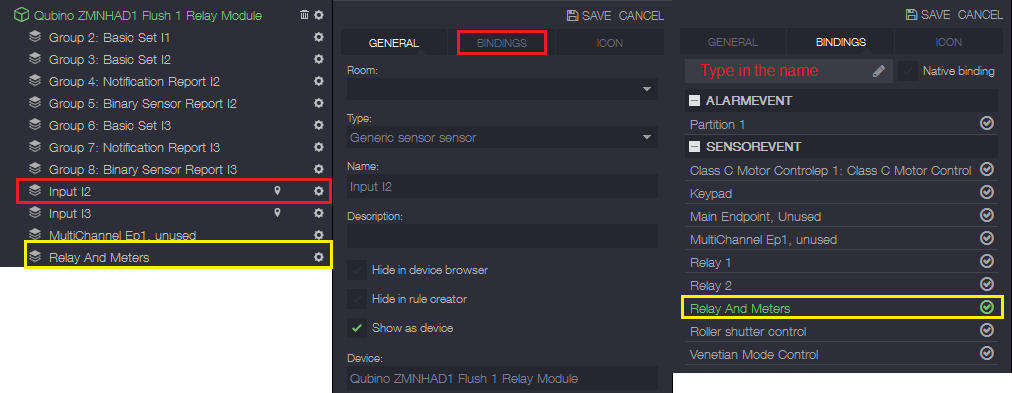

I got a reply from Zipato today:
”We have done a few changes to some devices and Qubino modules as well.
I have tested the Inputs on a few modules and it is true they don't work initially. Then I tried to bind the inputs to the Relay switch endpoint
and then it worked. It does have a delay though, few seconds, but it does work. This is the way it was intended to work but we will deal with
the delay so that it react almost instantly"
A bit weird that they break something that was working fine. I will try tonight (now at work) when i arrive home.

I got this image from Zipato support. Forgot to add it to my previous post. Will try the procedure tonight.
I can configure and save it. But when I go back in the configuration mode the binding is gone...

I don't understand from the image what i should do. My ZMNHAA2 has a different structure anyway (see attachment). Don't have the ZMNHDD1 (flush dimmer) connected now, but as the I2 input on this relay on/off module is also not working, it shouldn't matter anyway.

I got response from Zipato today, they have changed some things.
I have excluded the module, resetted it (keep S-button pressed >6 seconds) and included it again. The i2 input is now detected!!! (without changing any other parameters). Zipato said to change the parameter 20, but i don't see the benefits of doing that. According to the manual it is for a 3-way switch??? However i just want to use i1 and i2 apart from eachother.
Like i said the i2 input is now working. However, very slowly. I have to keep the button pressed more than 5 seconds before the buttonpress is registered by the Zipabox. I have asked if they can fix that, then everything is working like it should again.
