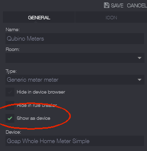

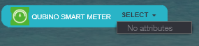

I have tried to add the Qubino Smart Meter three times to the controller (the last time using a 7-meter network cable to get the device (now installed in my electrical panel) close to the Zipabox, as recommended in the manual. Each time the result is the same. I get the device hierarchy in the first screenshot (I have renamed "Meters" to Qubino Meters and "Whole Home Meter Simple" to Qubino Smart Meter). I have also played around with "show as device" in different nodes, and tried setting the device type to "Generic Meter Meter" (after inclusion it was blank). I can never get the attributes to appear. The device I see in "Meters" under "Devices" on the right-hand panel is "Qubino Smart Meter", with no attributes (second screenshot). From your screenshots I deduce that it should be "Meters" (i.e., the node immediately above the attributes) which is the visible device. Like I said, I've tried to make it show up as a device (screenshot 3), but no luck.
I'm talking to support to see if they can help out. Any tips? Is this just the Zipabox screwing up when it adds the device?
In the end support fixed it by reapplying the descriptors.
