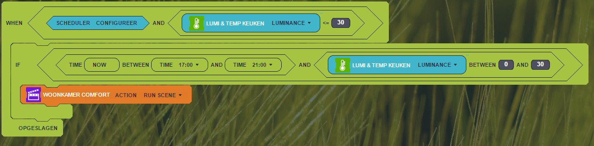

Hi All,
I've got a file attached. It's a rule to turn on my lights if my Zipato luminance meter is under
the 30%. The rule is working fine! But sometimes i've already put the lights on and i don't want it
to activate. Which blocks/meters etc etc should i add?
Should be like in the file attached but then added:
"if light is already on, do nothing"
Please help me :) thanks!
Kind regards,
Marco
hey,
1. you don't need the scheduler
2. in the if clause add "and if switch/light is off"
that should work
hey,
that should work
