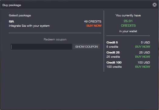

hi sebastian
It would be good to make a demonstration video of how this SIA DC-009 protocol is configured in the zipato controller.I tried to do it once and it did not work.
