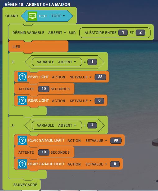

I want to turn on several lights randomly when I am absent (simulate by the switch test). I do not understand why it does not work. Eventually it will be several lights that will turn on randomly trigger by arming the alarm system.

Here are 2 examples how to use RANDOM function.

Hope this helps, it is not a simple setup but it works.
