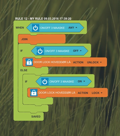

I have a lightwave remote witch are working great with Rules.
So now i want to ask if it is possible to create a rule.
1. I press button 1 lock my door.
2. I press button 2 unlock my door.
is this possible to do in one rule or do i have to use two?
(just more fun if i can do it one :-) )
Have already tried different ways to do it but no luck only one button can work.
-Allan
Hello Allan,
When you are working with devices which create "events" and not change their "states" you should put those devices in When puzzle and following action underneath of it. You need to make more rules but at least you will know that they work and they will be easier to troubleshot.
