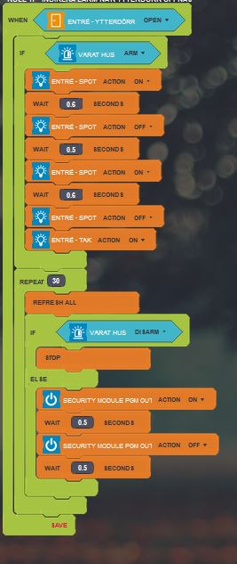

Have had problems with the repeat rule previously and also read that the "Repeat" function was broken for some time. Is it (repeat feature) fixed and should be working now??
I am trying to create a rule that:
1. Reacts/starts when a door is open and Alarm is Armed
2. Flash a Light two times
3. Turns on another Light
4. Flashes (turn it on and off repeated) a LED connected to the PGM port of the Security module.
1-3 are not a problem, issue is when I get to step 4
Here I like to do the following repeated 30 times
1. Refresh ALL (To get refreshed status if the Alarm is Armed/Disarmed)
2. Check if the Alarm is Disarmed
3. If Alarm is disarmed STOP executing rule
4. If Alarm is Armed Turn LED on, wait 0.5s Turn LED off. wait 0.5s
Should this work?

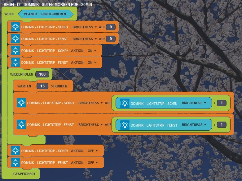

Any news about the repeat function, i think it isn´t working for me, i would like to fade i light in the morning from 0% to 100% brightness in 1% steps, but the light only goes on and stays at 1% :(
Rule is attached...
Dominik
Rule is attached...
Dominik
Are you sure that the rule is running? Try it with out the scheduler.
