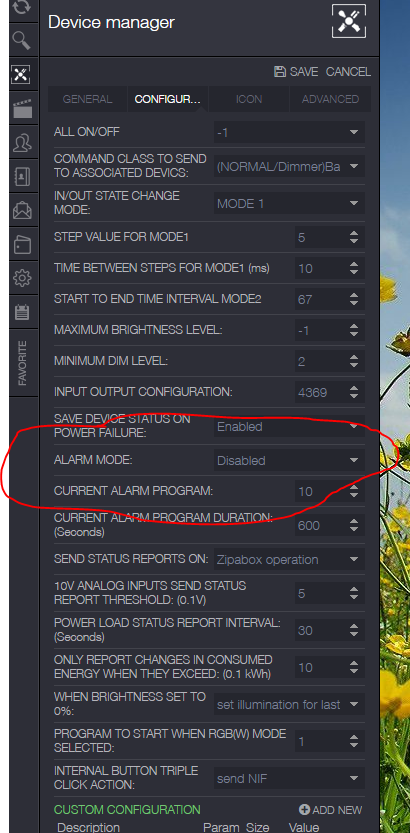

I have never tried the alarm mode via the parameters, but check out the manual, parameter 30 http://fibarozwaveshop.com/PDF/fibaro-rgbw-controller-2.1-2.3-manual.pdf. Although under the configuration page there is an option for activating the alarm mode, see attached.

i tried the parameter it does not work !!

contact support. So even setting the alarm mode in the configuration didn't work? This isn't good.
