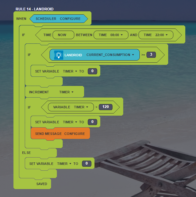

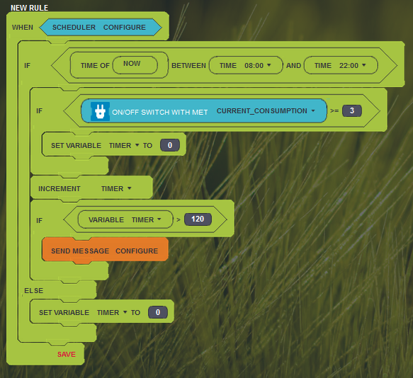

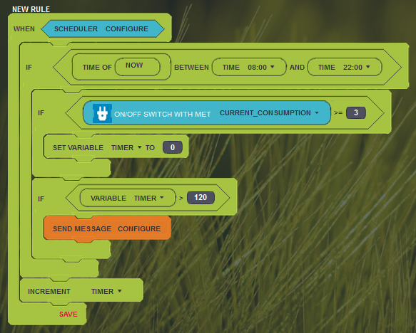

Enclosed please find a rule created according to your requirements. Please note that for clarity, the example assumes a Scheduler running Every Minute (hence the test for Timer > 120 minutes).
Please also note that this rule tests for 120 minutes absence within your specified time window, as stated initially. If, on the other hand, you want to also check that the robomower actually returned home for the night, and get notified at 8:00 if it didn't, please use the second rule instead.
