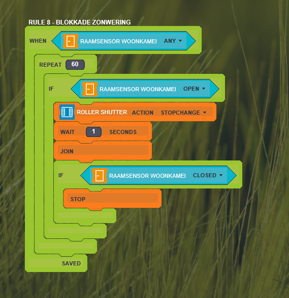

i am trying to creat a rule that stops the roller schutter from working when the window is open.i got it to work but when i open the window the roler shutter stops only 1 time afther that the roler shutter works again en i have to close the window en when i open it the roller shutter stops again. So what i need is a rule that repeats continuously.
i try to repeat the rule 60 times this works but stil only for 60 seconds
Hello, try to do the oposite :
When Roller (ANY) Then
If Window (OPEN) Then
Roller (STOP)
Roller (STOP)
HI,
create a variable for the statement of the window.
If open variable=1
If close variable=0
HI,
If open variable=1
If close variable=0
hi Jacques
Do you have a jpg.file with an example of the rule. i dont now how to set this up.
hi Jacques
