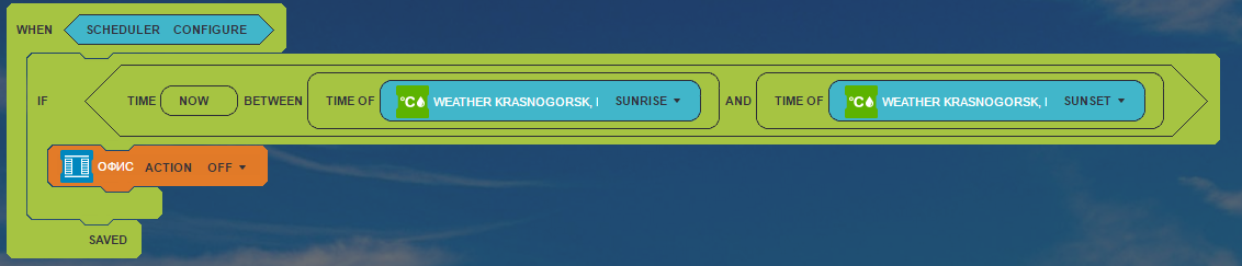

Rule don't work
Help me please. Why rule in attach are not working?
Control Center...
I would recommend using a virtual sensor or switch to hold the state of the sunrise and sunset. Make a separate rule with scheduler (astro) to set the virtual sensor to on/off. Then you can use this sensor in your rule logic
Yuriy.
It seems logic but it doesn't works. I had the same question, in a ticket, log ago and here is the answer:
"Hello Henry,
as you noticed this will not work, this is how the system is currently configured.
I am not sure what you are trying to accomplish but I would recommend that you
create two separate Rules with a scheduler in the WHEN part of the Rules.
Enjoy the holidays.
Hrvoje"
Just create a virtual switch and turn it on in sunrise and turn it of in sunset.
Yuriy.
"Hello Henry,
Enjoy the holidays.
Hrvoje"

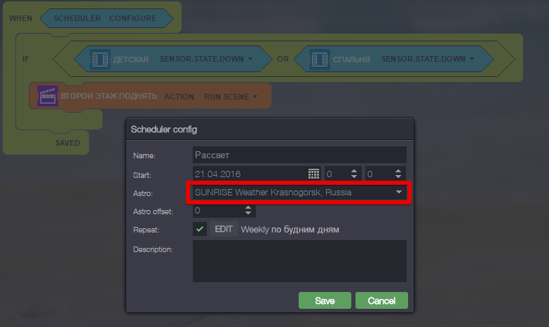

Thanks for your answers. I tried make it without virtual switch, only astro in scheduler. And it works!
