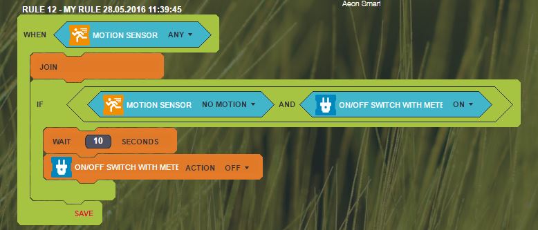

Dear Roger,
Please try to check the picture in attachment and tell us is this the rule that you want to create.
Pero Zovkic
Dear Roger,
Pero Zovkic

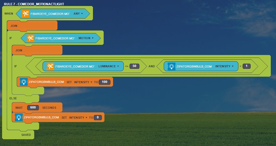

Roger,
Find attached my example for motion activated light, it is using a Fibaro Motion Sensor and Zipato RGBW Bulb. This rule will allow the bulb to keep a dimmed setting if already on.
Roger,
