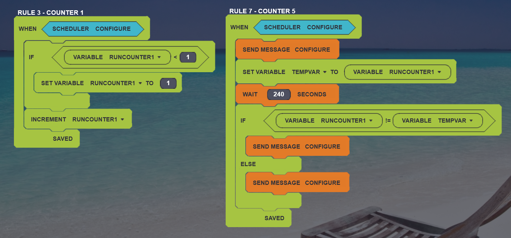

The enclosed two rules will demonstrate this quite well: Each of the rules have a Scheduler. The first rule is set to execute every minute, the second will execute every five minutes. The SEND actions simply send messages. If you have PRO, the messages can also include the contents of the variables.
The FiveMinuteRule store the value of a variable which is incremented every minute in the OneMinuteRule, into another variable, then the rule waits for 4 minute, then compare the contents of the variable with the variable holding its initial contents.
The variable will have been changed every minute by the OneMinuteRule, and will be different when tested the second time inside the rule.

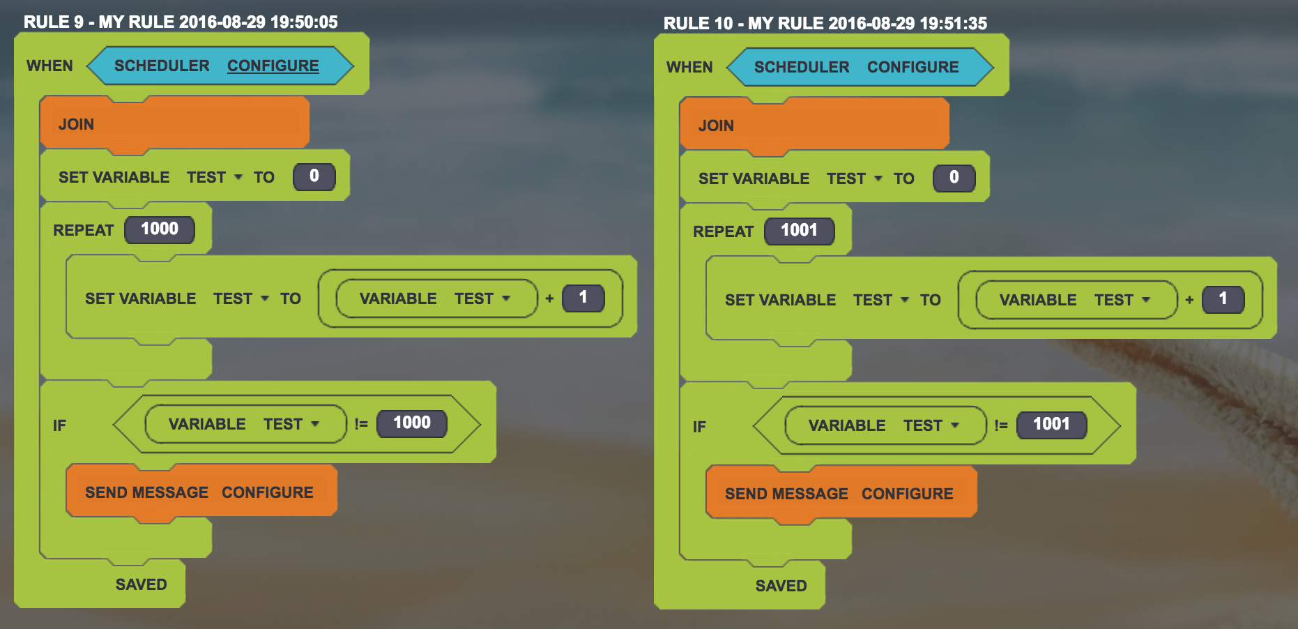

But now I tried it, I created two rules, both executing every minute, just counting the same variable up 1000 and 1001 times. (Attached, please check if I did something bad, tried it with the JOIN statement too, just to be sure that that special thing didn't pause the rest of the rules..)
I don't have the pro version so I cannot check what the variable ends up being but it isn't correct anyways... so the executions are interleaved. (If I just leave one rule running I don't get any errors.)

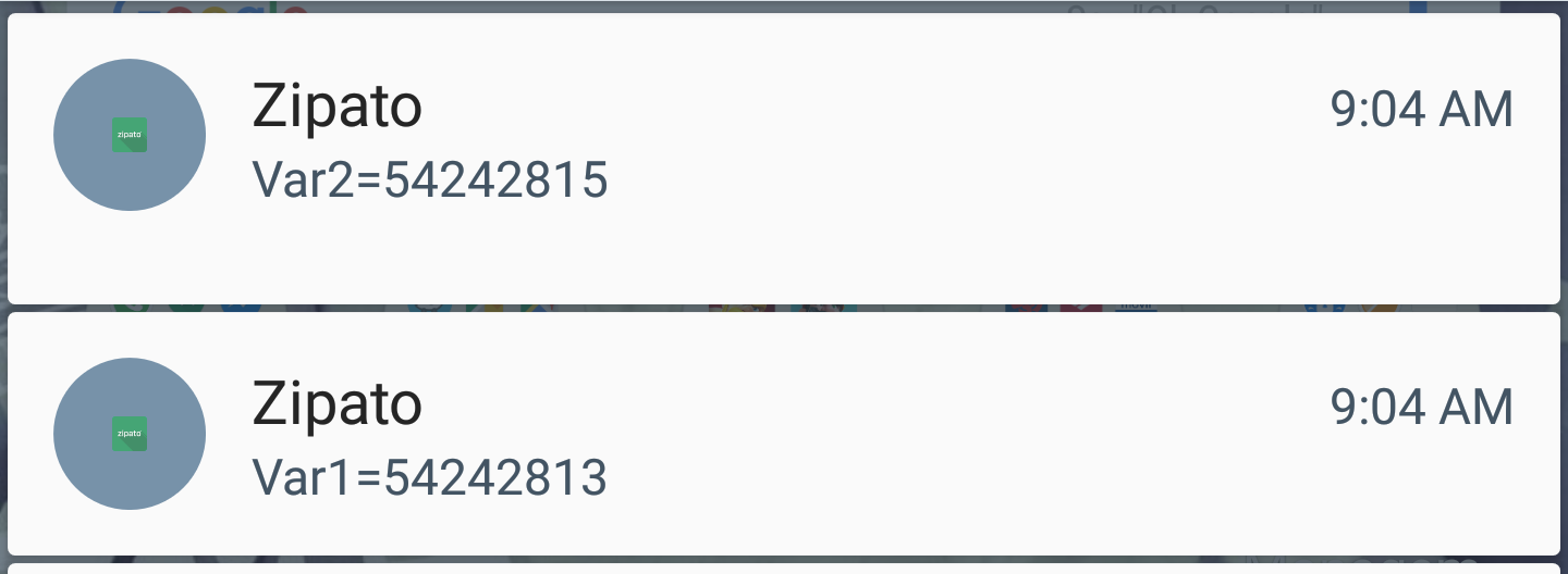

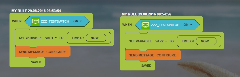

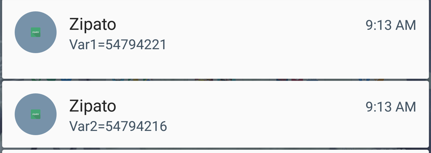

I think rules cannot simultaneously run, this is not a multicore processor that can run different tasks (with different core) at the same time. In my opinion the processor runs one rule after another as fast as it can, WAIT and REPEAT puzzles don't "trap" processor execution, in my opinion they continue processing other rules until the Timer or the Counter is done. I created a rule to show the secuencial process of the rules, I guess the rules run based on the number of rule, i. e. Rule 1, Rule 2, Rule 3, etc.
First image shows the rules I created as a "timestamp" demonstration of when the rule runs. On the second image you can see VAR1 has a smaller value than VAR2, since I created and saved VAR1 rule first and then second. Then I moved VAR2 rule on top of VAR1 rule, syncronized rules, and then run again and now VAR2 has a smaller value than VAR1, third image.
I just checked, they do run in parallel. Check Robert's second comment thread above.
If this processor was able to run simultaneously then the timestamps on my example should be identical. I just proved that just changing the order on the rules changes the timestamp accordingly which proves the sequential processing. Only multicore processors can run "simultaneously".
