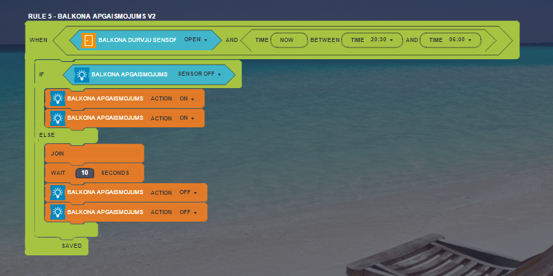

Here is my example!
Here is my example!
or just toogle the light when door open (and use sunset to activate time)

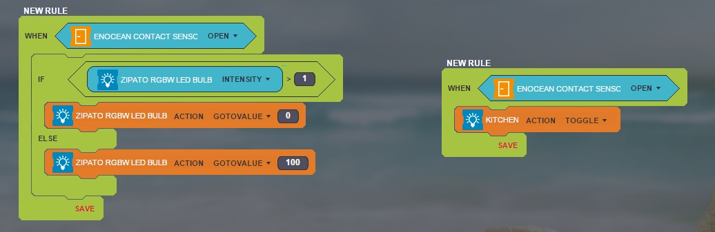

Glad you figuered it out. Here is another solution without using a virtual switch.
1st example is with a RGBW globe as the settings are different than an on/off module
2nd is even easier with a simple on/off module
