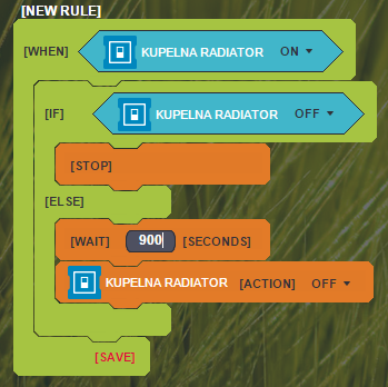

Michel, give it another try. Use:
When lamp on,
if lamp turn off - stop the rule
else count 15 minutes, than turn off.
I have attached picture but it is also a trial error case as not sure it will work until tested.
You can acrially replace the part "Stop" with send email message and if you receive an email message, you know the 1st part is working.
