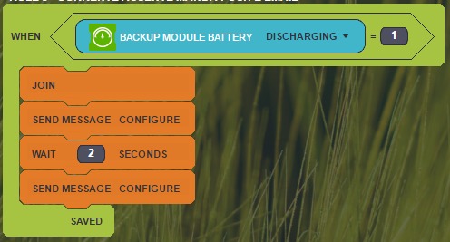

I need to create a rule that send me a push (and an email) when there's a power failure.
I'm using the attached rule but:
Case 1:
If I remove the LAN cable and leave the power I get the stick connected to the cloud. At this point I remove the power and I receive the push and the email; the battery status is now DISCHARGING.
Case 2:
If I remove the LAN and the POWER at the same time (simulating a power failure that switch off also my lan) I get the zipato using the battery backup, connected to the cloud and goin online but I didnt get any push and/or email so I suppose the rule it's wrong.
The other strange things is that the battery status is NORMAL andnot DISCHARGING.
Any idea?
thank you
try using a wait command of 10 seconds after the join block. Maybe the power failure is not allowing the usb to register fast enough.
